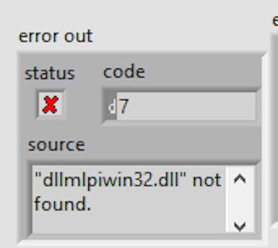

We are facing Issue with EXE file creation in Labview with MLPI library.
Please find the error message in the attached image.
About the Problem.
While runnning in my Labview source code the Program and logic which we build is working fine.
But while dumping the source code into the Windows application (.exe) format we start facing the above error. And further the mlpidll is  added and tried in all combinations yet issue wont resolved.
Kindly suggest
Thanks and Regards
Samkarshan V
Best reply by HellCoder
basically you have to copy the *.dll in the directory of your Executable:
You can find the *.dll in your installation folder of the MLPI SDK. You have to use the correct dll for x64 or x86 Applications:
C:\Program Files (x86)\Rexroth\MLPI-SDK\01VRS\mlpiCoreClient\bin\win-vs2012-x64
C:\Program Files (x86)\Rexroth\MLPI-SDK\01VRS\mlpiCoreClient\bin\win-vs2012-x86
There exist an example in an older version of the MLPI SDK Version 1.11.4.0:
Setup_MLPI_SDK-11140.zip\Setup_MLPI_SDK-1.11.4.0\AddComponents\MLPI_SDK-01VRS.zip\mlpi4LabVIEW\samples\sample - Common MLPI\executable\builds\
You can have a look at this example.
