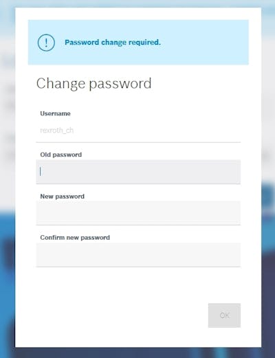

Then I logged out and tried to log in with this new user. Then I have to set a new password:
I think this procedure isn't really user-friendly. Perhaps it's a bug?
I think a password change should be suggested with the standard user (boschrexroth) when I log in the first time.

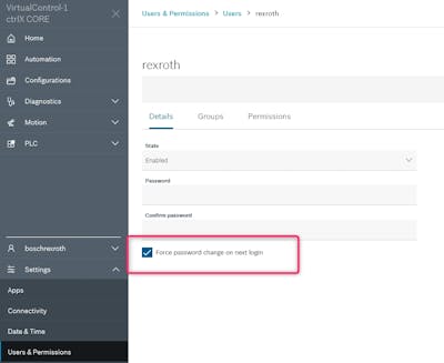

Well, with ctrlX WORKS version 1.4.1 I found the checkbox "Force password change on next login", see screenshot:
Finally, I've got the answer.
