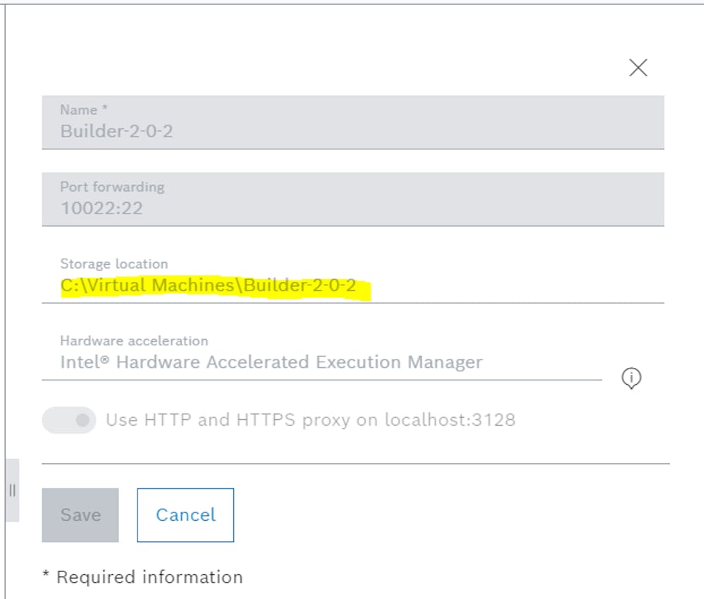

You can find the VM data at the storage location specified in ctrlX WORKS.

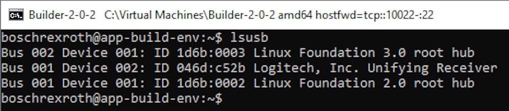

Here is an example implementation passing through a USB mouse/keyboard reciever from the Windows host.
IF "%ARCH%" == "amd64" (
    qemu-system-x86_64.exe ^
    -name "%NAME%" ^
    -machine q35,accel=%ACCEL% ^
    -smp 4 ^
    -m 4G ^
    -netdev user,id=eth0,%PFW% ^
    -device virtio-net-pci,netdev=eth0,mac=DE-AD-BE-00-00-01 ^
    -drive "file=%QCOW2%,format=qcow2" ^
    -drive "file=%UDIMG%,format=raw" ^
    -display none ^
    -nographic ^
    -device nec-usb-xhci ^
    -device usb-host,vendorid=0x1F75,productid=0x0817
    exit /B 0
The last two -device flags are the required changes from the default. I can now see the reciever in the usb device list.
