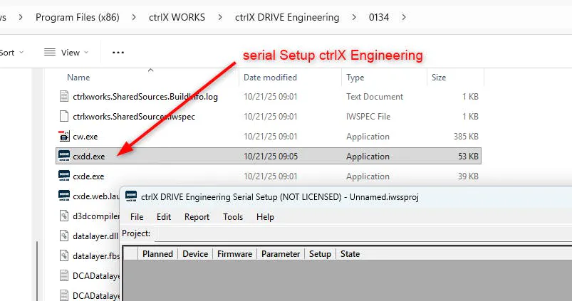

The shortcut to start is is in the ctrlX Directory

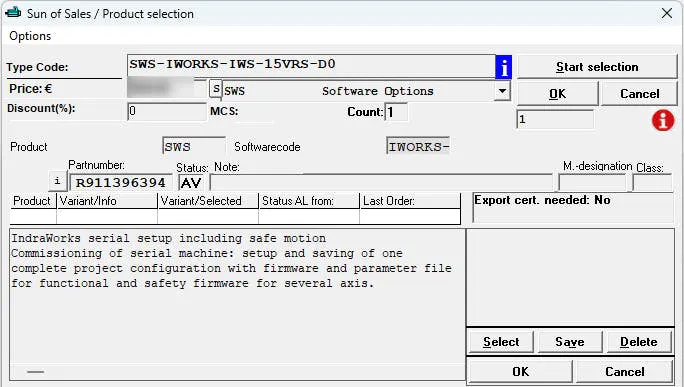

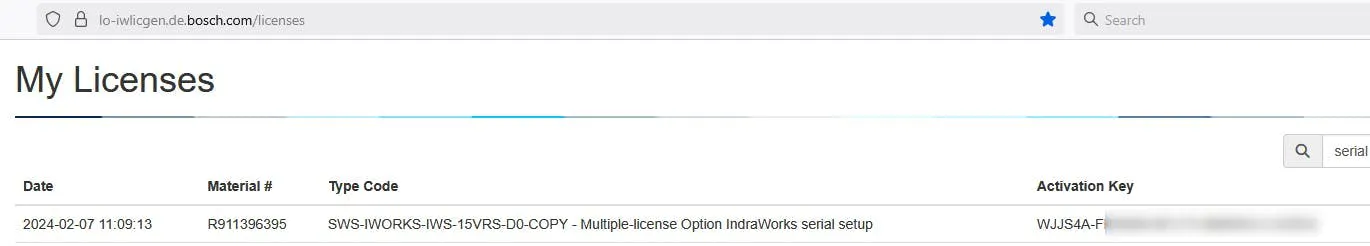

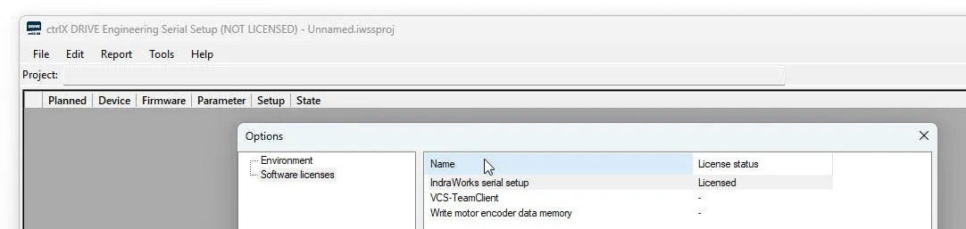

I can use it. But to save and use (serial setup) projects I have to buy a license. The license for indraworks 15 serial setup is accepted.
I can buy a license, but its a Indraworks 15 license. With Number R911396394. Do we have a license for ctrlX and does that have the ctrlX naming in it or do I have to use the Indraworks 15 license ...?

While I do not get a answer I will give the answer myself.
So for serial setup in ctrlX Engineering, you need a license that is the same as Indraworks 15 serial setup. So you have to order IW15 serial setup for example with the R-number which is shown above.
