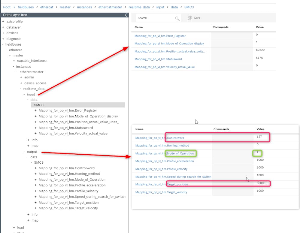

  4. From now, the data_containers (MDT/AT) related to the SMC3 card are registered by the datalayer and access is provided in general.
  5. Either use our website to access or optional any other Rest-client like Yarc/Rested/…

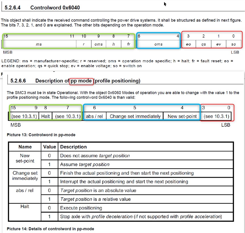

Simply command the SMC3 in the corresponding ‘Mode of Operation’ ( -> 1 – pp mode positioning) and operate the ‘ControlWord’  (like described below) should bring the stepper in action.
A HOMING message is part of the MDT-mapping. With respect to the variety of homing options further details are available in the attached SMC3 datasheet.
Navigate the datalayer tree and enter the data directly in the website or operate the data-point using the corresponding url/payload by any Rest-client for instance.
  1. OPMode
    Mode of Operation = 1dez (ppMode Positioning)
    Mode of Operation = 3dez (ppMode Velocitiy)
  2. ControlWord
    Example - details on datasheet
    decimal-valueEnable Power bit so/ev/qs/eo15Rel. positioning (abs/rel bit) +6479Change set immediately        +32111New Setpoint                        +16127

In case of operating the SMC and the stepper is not reacting like expected without signing Error-flag it might be, that the SMC is running with configured microstep. Means - every set is subdivided by 256 microsteps. Keep in mind that 1 revolution becomes then 200 * 256 = 51200 !
It may be hard to realize that the stepper is operating correctly – since the movement is too small to recognize by watching.
