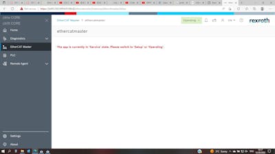

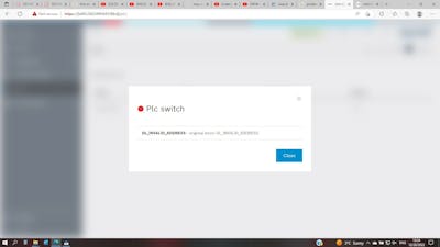

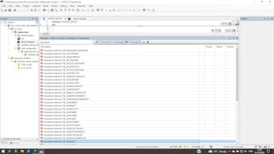

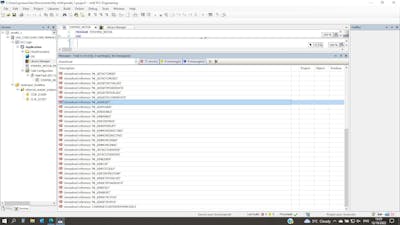

I have a problem with CtrlX Works V1.18. After update to new version take me a lot of errors.
Everything was working fine before this upgrade. I also upgraded the CtrlX Core apps. There give me this:
Pleace help!

In your system report we can see that all of your apps on the ctrlX CORE are still version 1.16. Please also update them to version 1.18 so they are fitting to the version of your target in the ctrlX PLC Engineering project and so the library versions. See collaboration room to get them and see release notes how to update.
The topic with the scheduler is known when a system is updated from an older version to 1.16 or newer. Please see this thread how to get rid of it.
