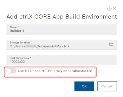

Do you need to communicate over a proxy to the network? If not please create a new one and unselect this button:
If you need to go over a proxy communication please select it and also download and run a proxy tool (e.g. px) on port 3128.
Additional hint: the ip address 10.0.2.2 is the ip of your windows host.
