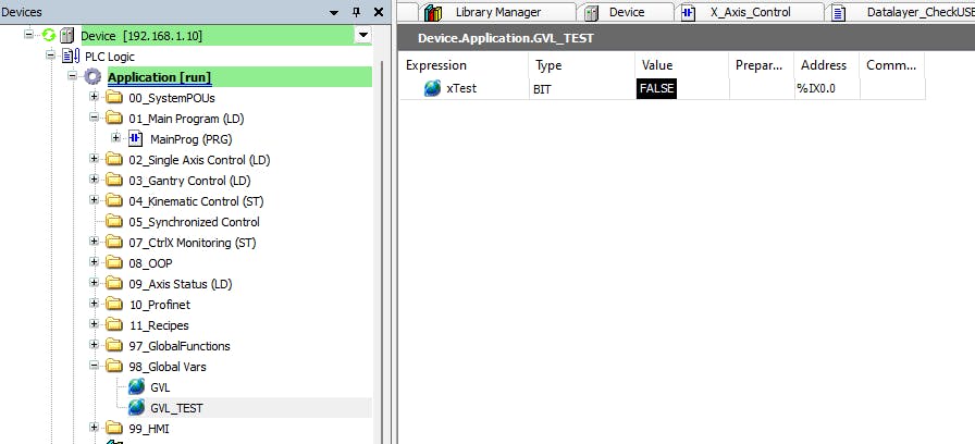

I'm trying to communicate with WebIQ using OPC UA
It's working properly with every variable, except with the booleans mapped to an IO address.
For example:
xTest at %IX0.0: bool;
If i monitored this variable online it is shown as a bit variable instead of a boolean. And this type is not recognized by the OPC UA.
The only work around I could find was to declare the variable as a bool, without adressing and using a program to do the map.
This looks a little awkward. Is there a right way to read a IO mapped variable in the OPC UA server?

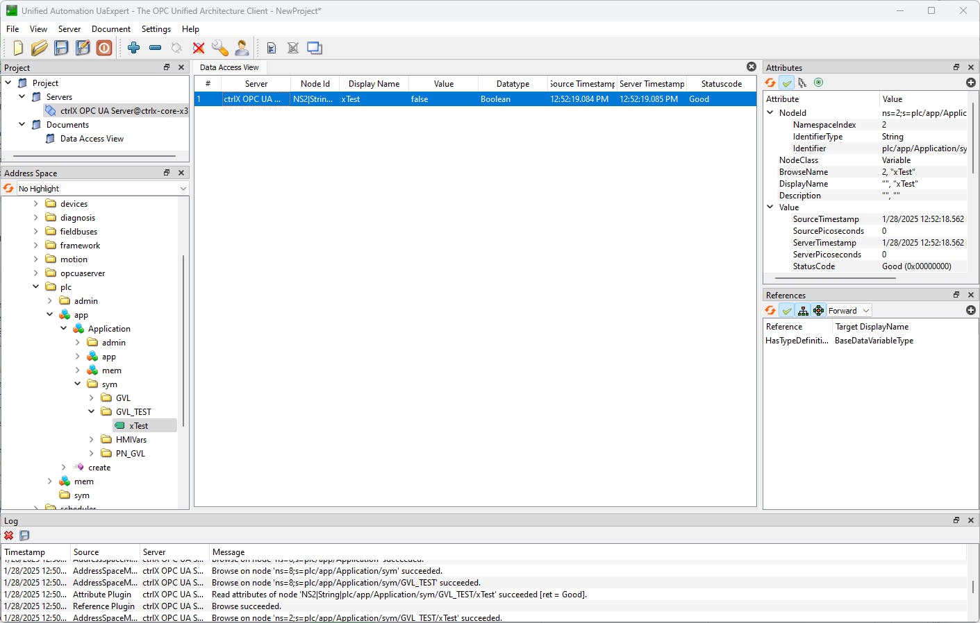

I have tested this with simply getting a IO bool into the OPC UA Server and reading with UAExpert. For me, I was able to get it to work with the instructions you provided. Even though the value is labeled as a 'BIT' in the PLC Engineering, it displayed in UAExpert without issue. Did you make sure to check the Symbol Configuration to expose your IO variables to OPC UA Server?
