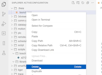

Approach 1:
  1. Delete the launch.json
  2. Uninstall the IDE App and install it again. (Really uninstall first and not just reinstall)

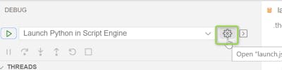

Approach 2:
  1. Press this button:
  2. A launch.json should open in which you paste the content of the attached launch.txt
This error can occur when pressing this control wheel button. You should avoid pressing it. We are investigating the root issue and are planing to fix it in the upcoming release.
