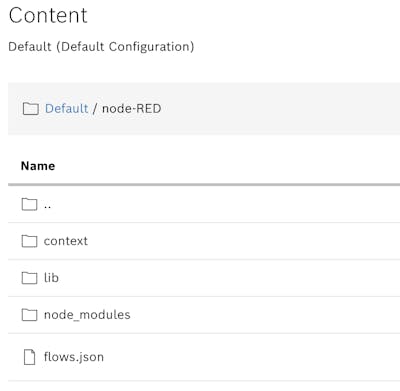

I have several ctrlX Cores and want to update a file within a configuration of an app. Via REST (implemented in a python script on a remote server) I want to update all of my Cores in the network with a new flows.json file. I already can create a new configuration via REST but my goal is to update files within an already existing configuration. How can this be accomplished?

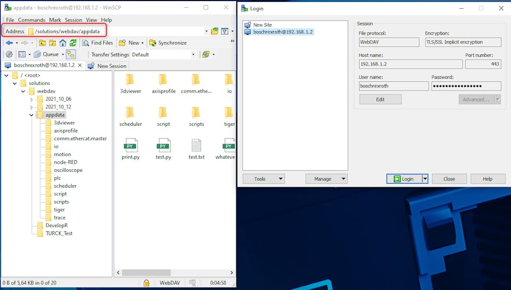

WebDAV is a standard protocol that can be used e.g. by WinSCP. After login you have access to the files in the solution storage. WinSCP is a free ftp,sftp,WebDAV,... client also available as portable version.
