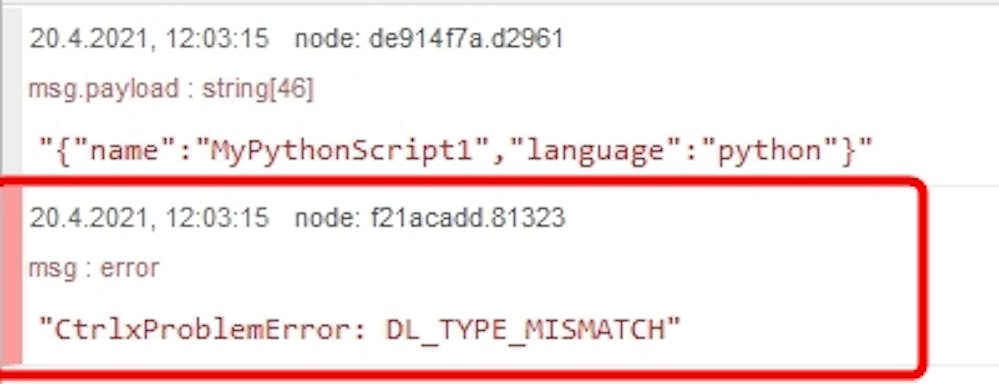

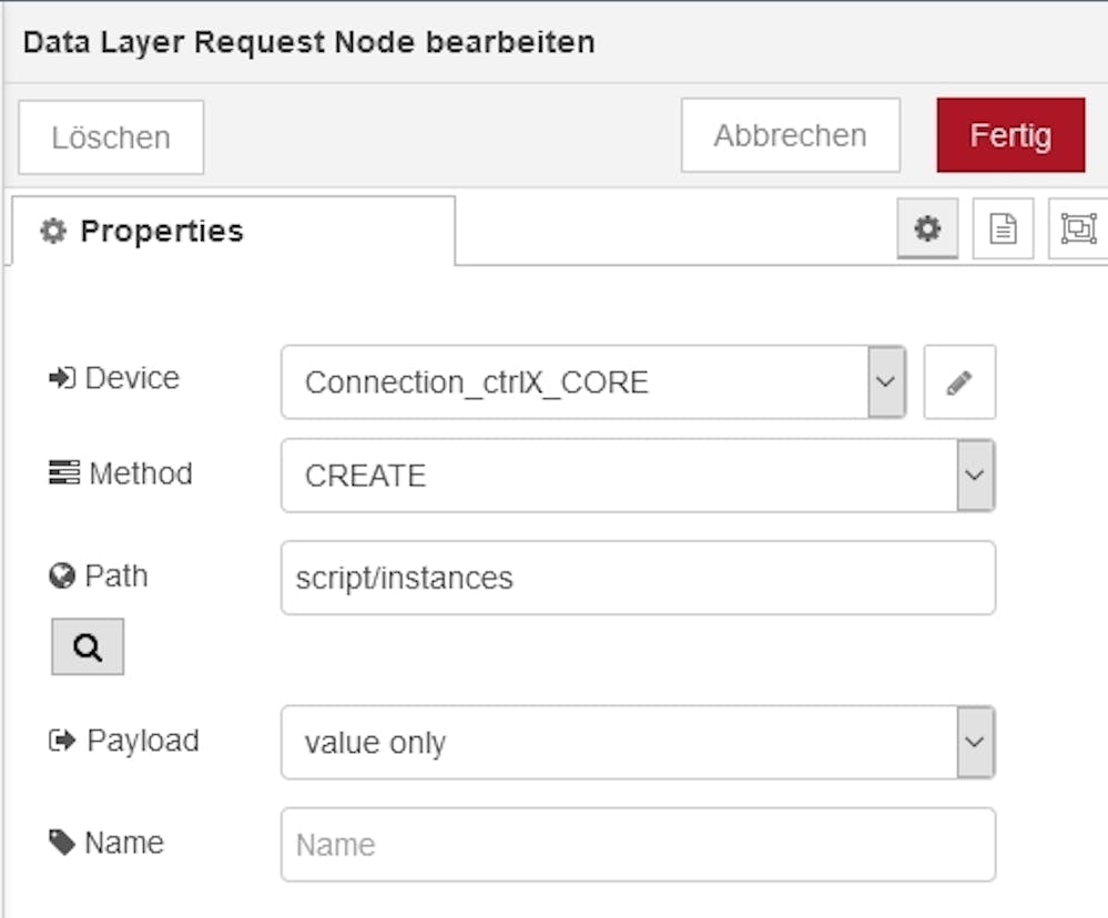

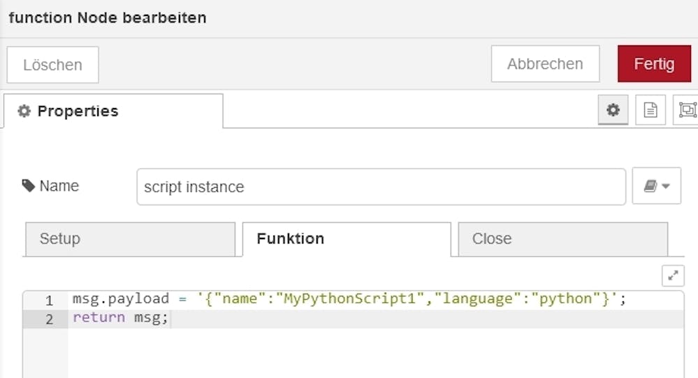

With the description above (YARC) it's possible for me. But I tried it with node-red and our ctrlx-datalayer-request node from node-red-contrib-ctrlx-automation. I try the following:
I did some tests with objects and with string as payload. But I always get the error message:
Any hint's? Thanks.

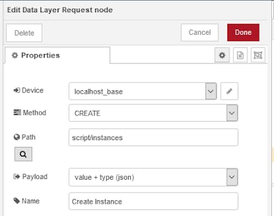

First you have to choose the payload as "value + type (json)" because you are trying to handle over an complex data type.
Second your payload including the object have to look like this:
var newMsg = {};
newMsg.payload = {};
newMsg.payload.value = {"name":"MyInstance3","language":"python"};
newMsg.payload.type = "object";
return newMsg;
