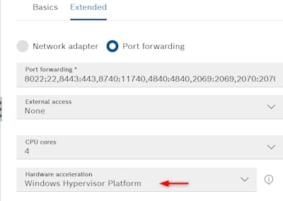

When I start a virtual CORE I get this message and it takes about 5 minutes to get my virtual running! ๐
I already updated ctrlX Works to version 1.20.11
What can I do!?

You might try switching the hardware acceleration to Windows Hypervisor Platform.ย See the extended properties of the virtual device:

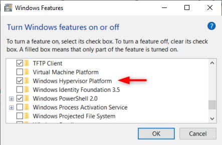

Make sure that this feature is enabled in Windows:
