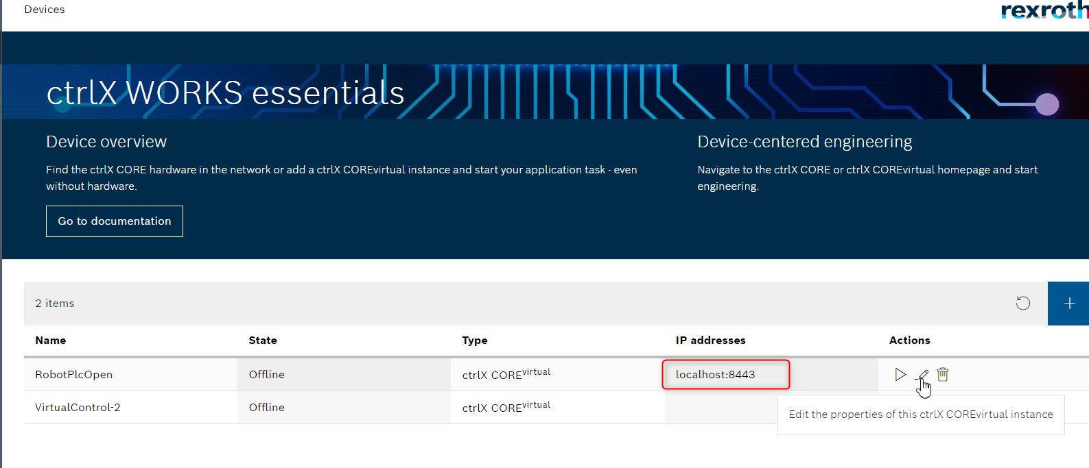

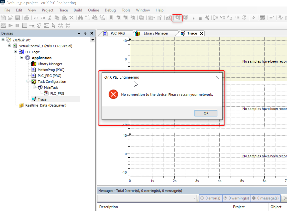

I got an communication error each time I try to download or log in with my plc program in the PLC Enginnering to my virtual control even if I set my virtual control IP address as port forwarding to "localhost:8443"
(see attahed screenshot )

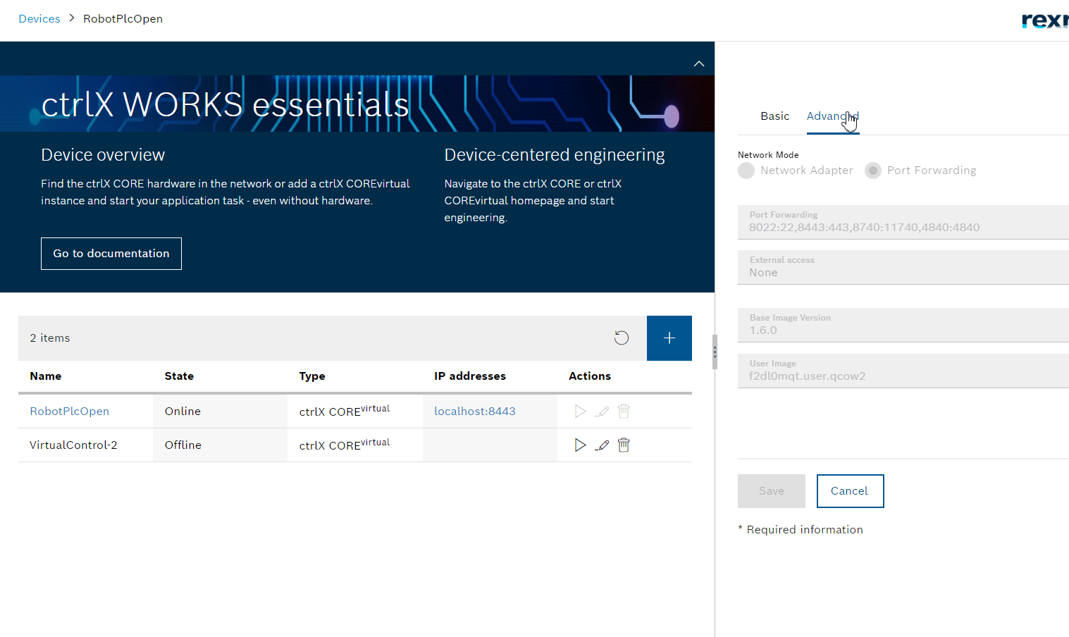

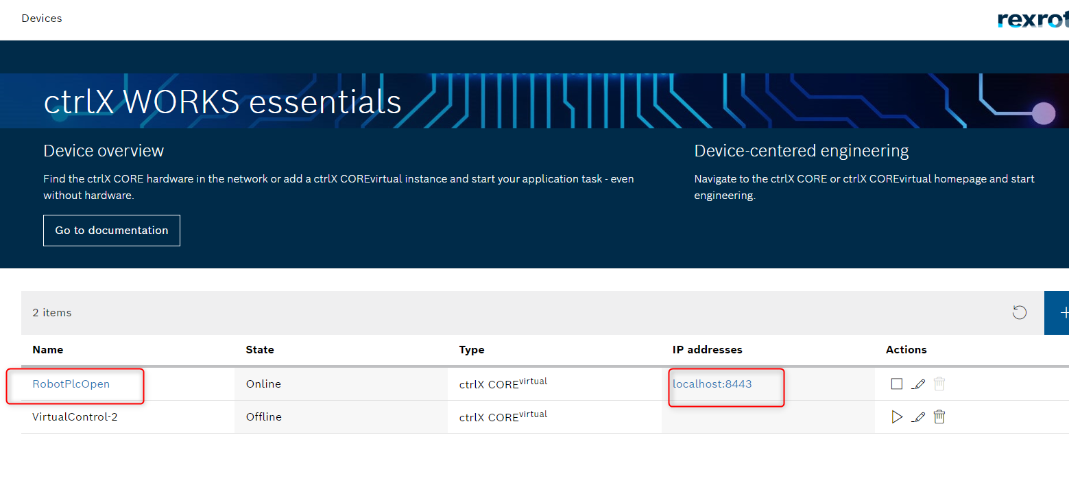

yes, should be possible. Once The certificate error occurs the PLC Engineering should be closed and reopened. Then a new certificate will be generated.
In WRK-V-0108 a better message appears.
