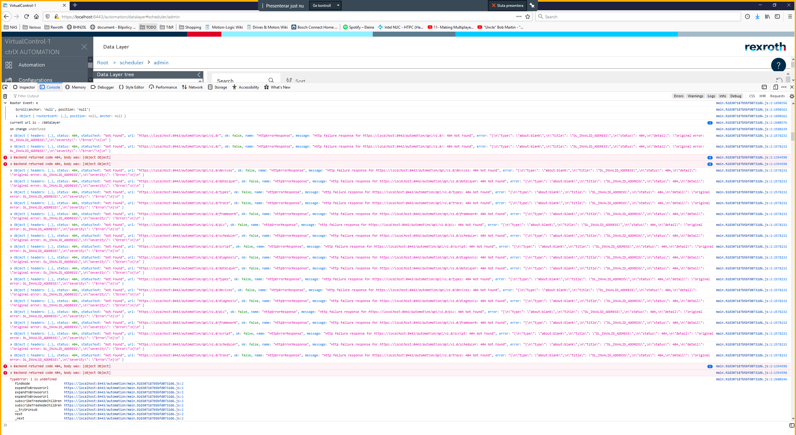

Error 404 in datalayer when using namespace attribute
When using variables with {attribute 'namespace':=''} in the plc the datalayer goes down with error code 404. Is this a known issue or it is not prohibited to do like that?
