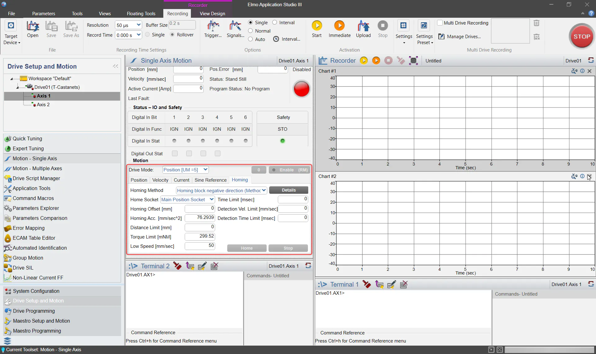

However, I am encountering an issue when using the MC_Home function block. The homing parameters configured in the Elmo EAS III software are not retained after a restart. Once the drive is rebooted, the homing settings revert to their initial/default values.

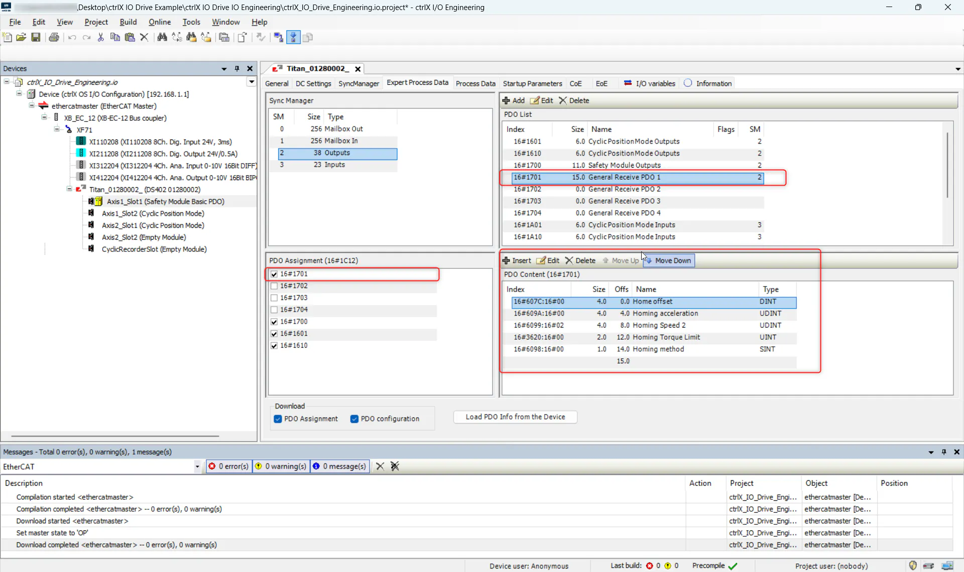

ctrlX IO Engineering PDO Content:
I am trying to pull out the parameters so i can edit the homing parameter values from my PLC program instead of using the ELMO EAS III software.

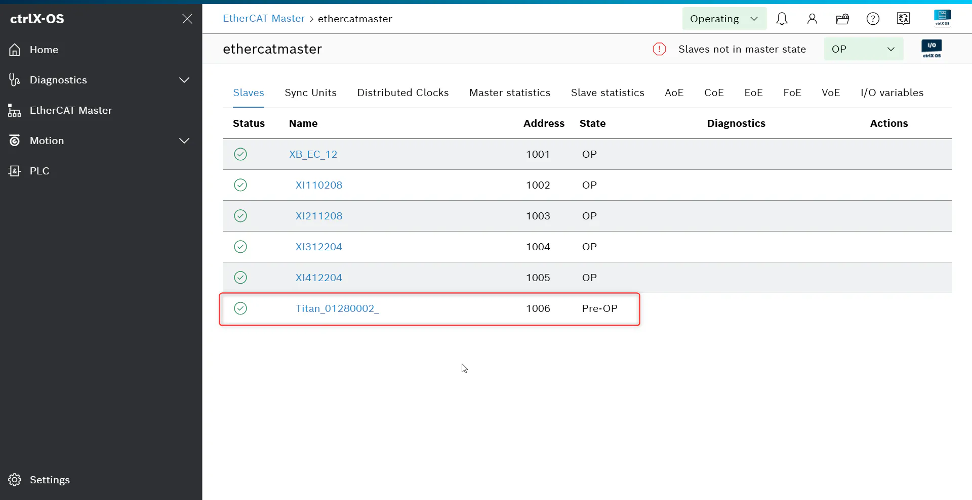

When i download my ctrlX IO engineering EtherCAT configuration, the ELMO drive state will be in Pre-OP and will not switch to OP.
Below is my ctrlX IO project v4.6.0
