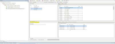

As the configuration of the IOs is done via a XML file and this one is generated by the ctrlX IO Engineering you will have to use this tool or generate the file on your own and put in the corresponding folder (ActiveConfiguration/comm.ethercat.master/config/<name of your masterinstance>/ethercat.XML) on the ctrlX CORE e.g. via WebDAV.
PDO edit functionality via REST API is currently not available.
