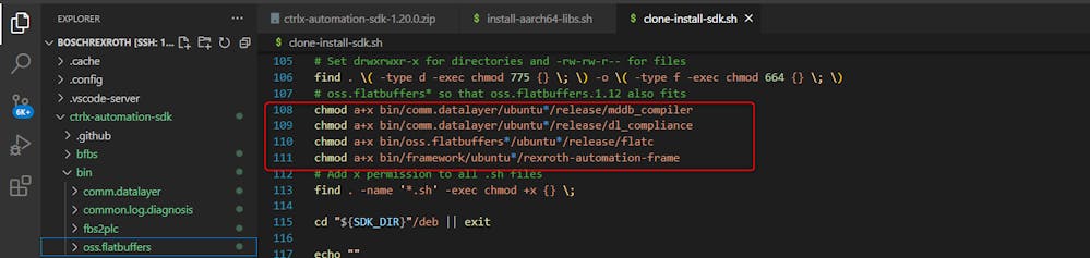

I found a issue in the clone-install-sdk.sh. The paths in this script are wrong, there is no "release" folder. Could you try to execute these comands again without "/release" in the path?
Wrong path in clone-install-sdk.sh
