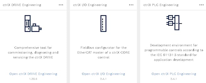

ctrlX Works v2.04 -- ctrlX DRIVE still v1.20?
I downloaded and installed ctrlXWorks v2.04.
All Engineering softwares are on 2.4.1, but not ctrlXDRIVE Engineering, it's still 1.20.5
Is that right or is something wrong?
Best reply by Jochen_Mueller
Yes.
  • ctrlX Drive will be provided as a separate installation file which are availalbe at the collaboration room (currently in the PT-area)
  • has its own release steps and version numbers. (not anymore combined to the ctrlX WORKS)
  • used ctrlX DRIVE engineering version is linked to the DRIVE firmware. You can still communicate with older ctrlX DRIVE Engineering to new DRIVE firmware, but If you want to have new screens for new drive function you have to update your ctrlX DRIVE Engineering.
