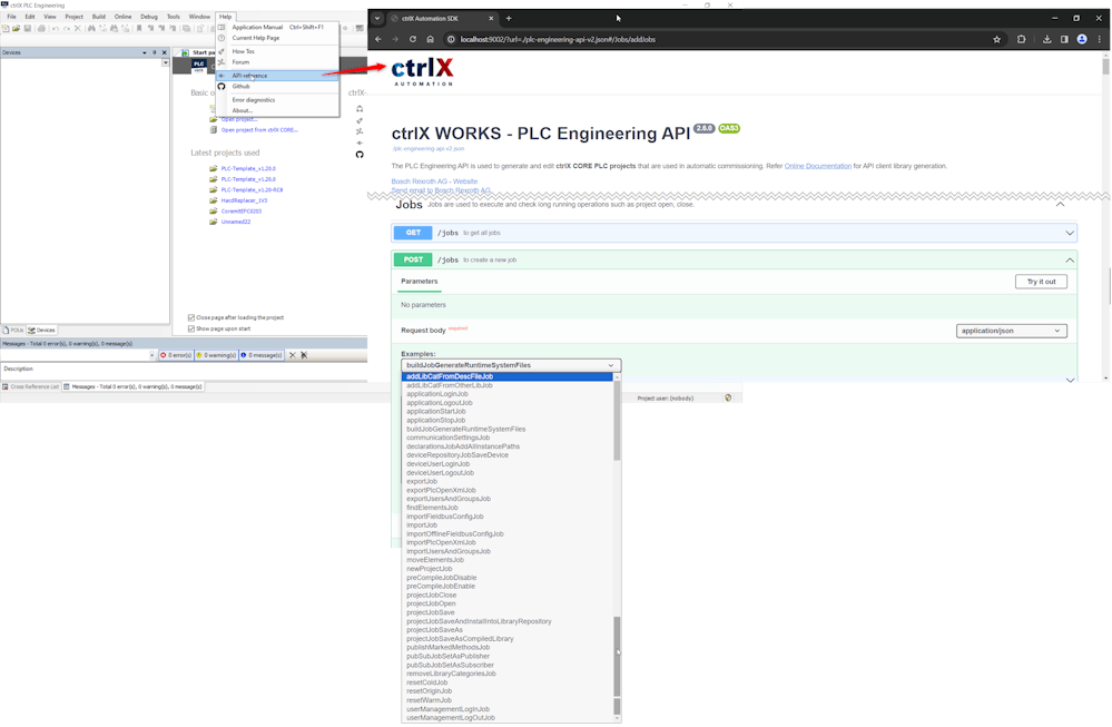

Hello,Â
are these functions now implemented in the API of release 2.4?Â
I can only find a build job for libraries. Â
Best regards
Feel free to check the API description deployed with the installation of the ctrlX PLC Engineering:
Available jobs in ctrlX PLC Engineering 2.4 are:
