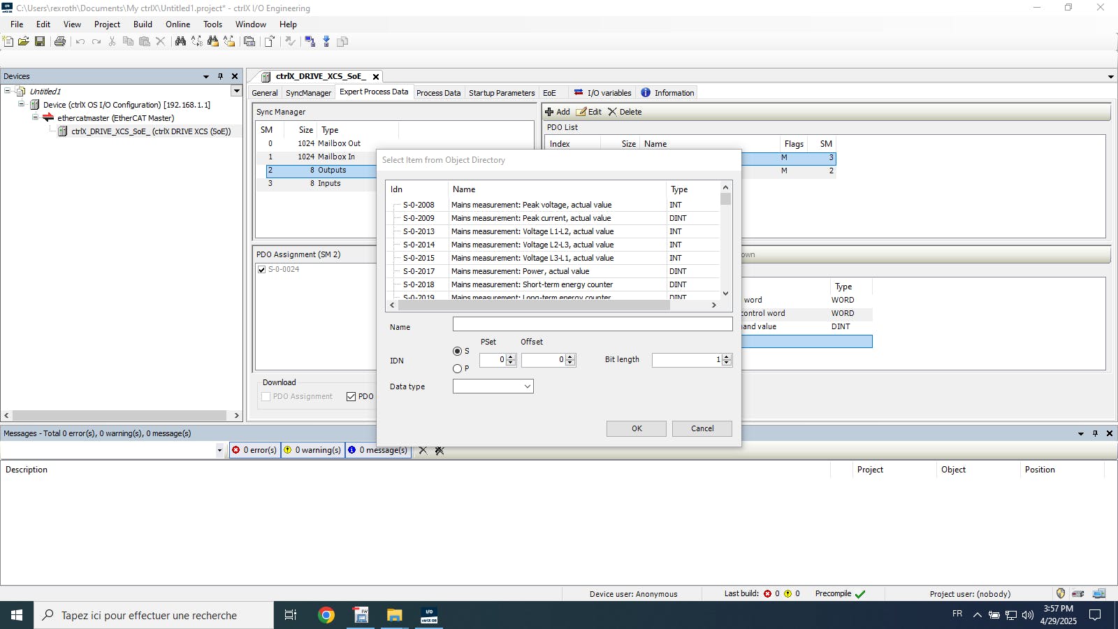

on IO Engineering 3.6, it seems that object dictionnary is not showing all parameters,
is there a way to fix that ?
I reinstalled IO Engineering, ctrlx Drive device repository, but still the same issue.
Thanks.

Like discussed in direct contact it seems to be a problem with the latest device description files 0606. Please try using older ones.
I will forward the issue to our R&D.
