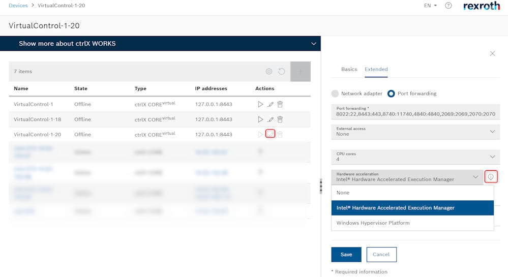

Hi Open,
ctrlX Works supports for its included virtual Maschines (ctrlX COREvirtual and App Build Environment) two hardware accelarations: The Intel Hardware Accelerated Execution Manager and the Windows Hypervisor Platform. Have you tried to activate the Windows Hypervisor Platform in the Windows-Features and tried to use this one?Â
You can also have a look at the extended Settings of your ctrlX COREvirtual. Clicking on the "i"-Symbol next to "Hardware acceleration" can also give you more information on what may be missing on your PC.Â
