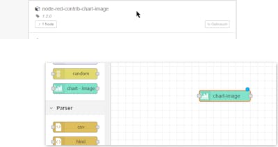

I just tried in the ctrlX VIRTUAL (today I have no ctrlX CORE in front of me) and the installing of the following palette worked. I didn't try the function.
After installing please close Node-RED and open again  !!
