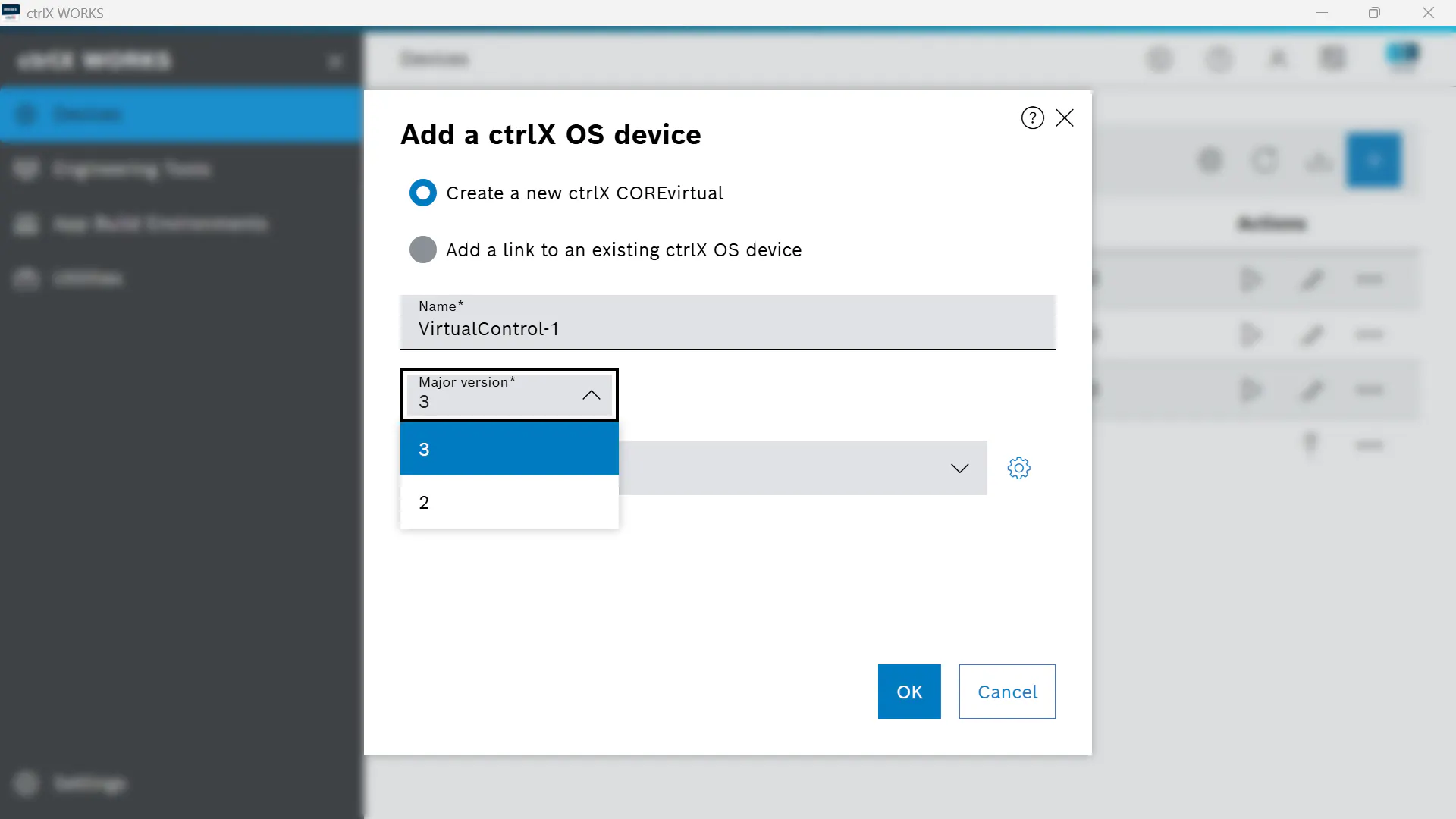

I just installed ctrlX WORKS 4.4.0 (Windows) and thought I could then also create a ctrlX COREvirtual with the major version 4, but this is not the case:
Is this still under development and will come soon or am I doing something wrong?

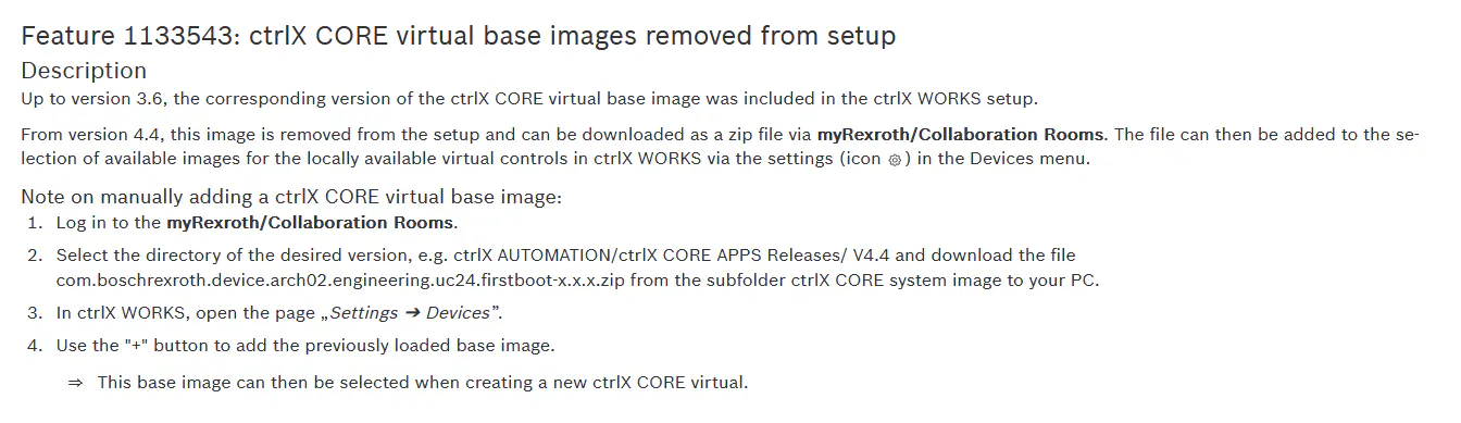

In the Release notes for the CtrlX Works 4.4.0, it states that the installer no longer includes the virtual core image by default. You can download the image separately from the collaboration rooms.
