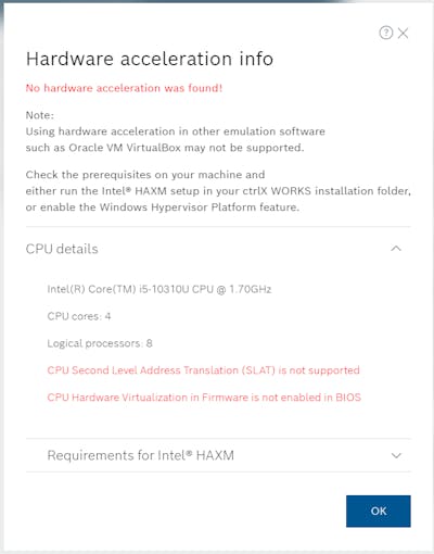

Checking ctrlX works settings I find the following messages.
Trying to install the HAXM again failed (this option is mentioned in the error message). System requirements are not okay, but that seems strange to me while it worked faultless before. I did not change anything.

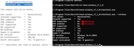

In the installation file of HAXM there is a check tool. It tells me VMX is not supported. But it should be supported as in the example left.
