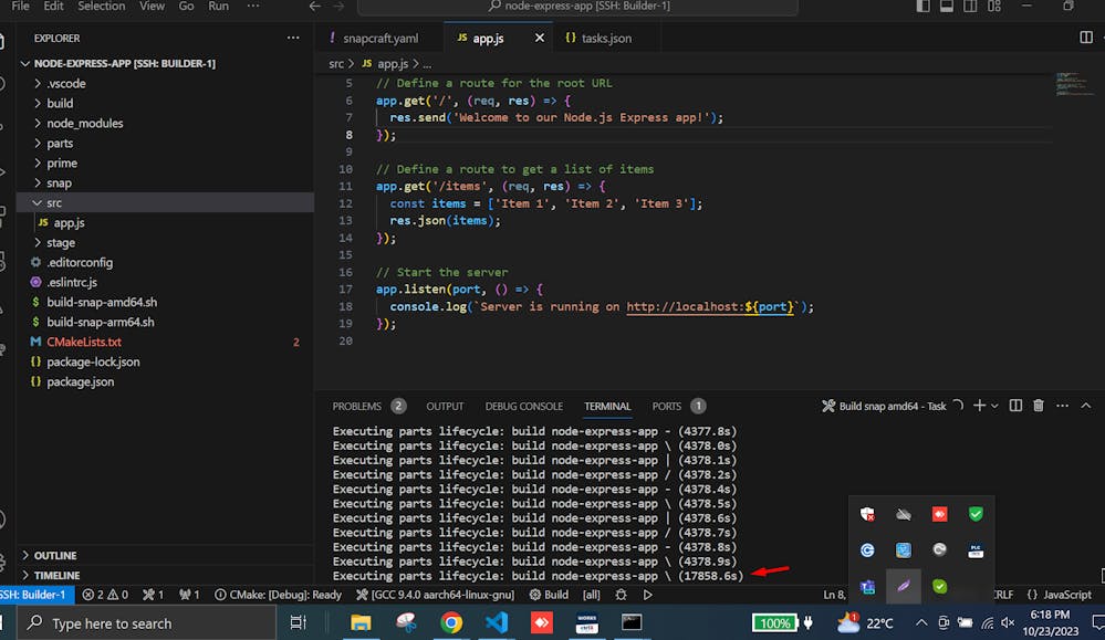

I have simple nodejs project, i am trying to build its snap application but getting issues, first of all, what i did,
1) Installed CtrlX works, installed and run virtual enviorment
2) Then create ctrlX CORE App build enviorement and started,
3) Using Remote SSH for vscode. and created nodejs application. npm install
4) then create snapcraft.yaml describe below, then try to make its by run task build -> amd64
5) it takes more than 8 hours but process is on-going, screen shot attached.
Plus i have also build an snap application of helloworld example available in ctrlx-automation-sdk folder but that provide me built fine,

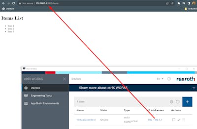

Best reply by jawad
Thanks everyone
I achevied it, Built snap app, then installed on ctrlx works. then I access the snap web app by ip address and the route define in code
