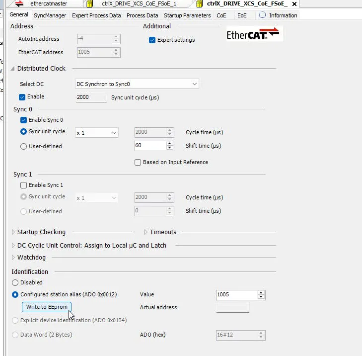

I am testing to assign to these drives a manual Ethercat Address like the one showed in the picture,

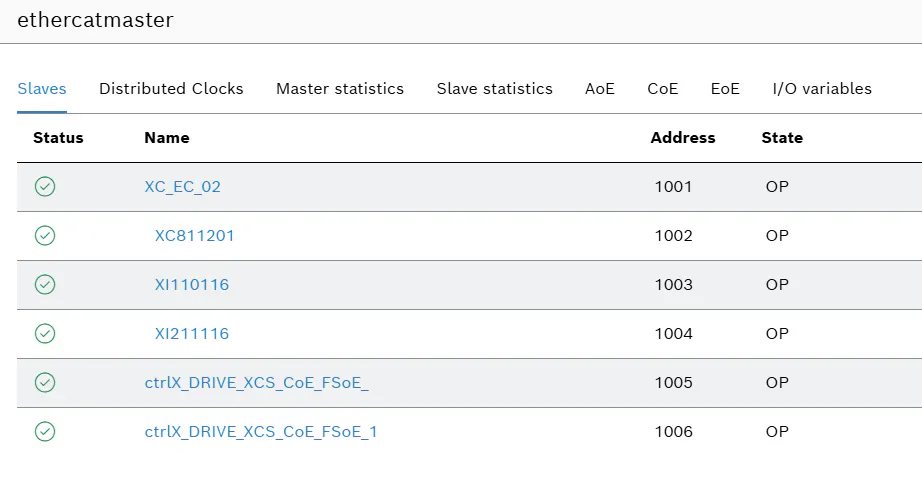

In fact, this 1005 address is automatically assigned if I click on "Disabled" and then the Ethercat goes to OP "Running",

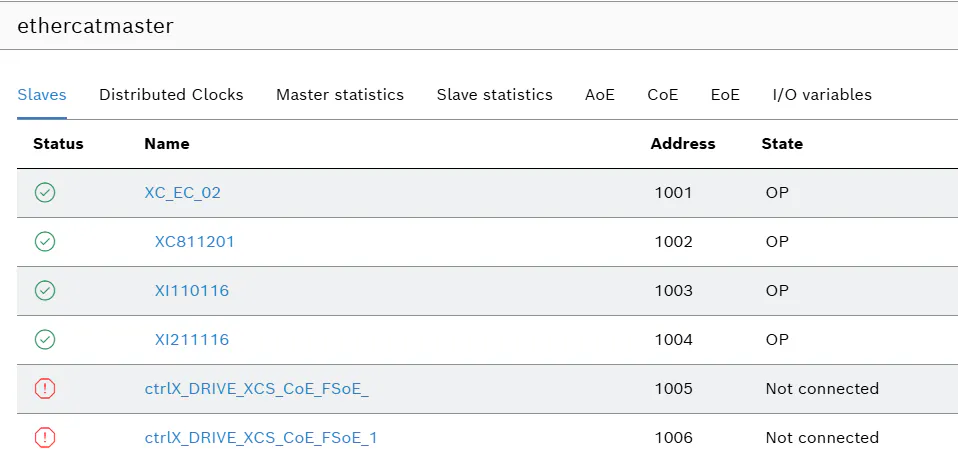

However If I change to "Configured station" and select a 1005 / 1006 address then the Ethercat does not recognize the drives
So the question is, if this possible/compatible? Can I select the Ethercat addresses that I want using the ctrlX IO Engineering?
