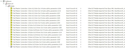

Is it possible to test if this device is compatible with SafeX C15 device in ESI file level. We tried to implement this to one application but it seems that none of those modules is a match for this device that are possible to configure for FSoE Connection in IO-Engineering.

Hello Laurie,
yes your are right if it is the same device then we need the Connection 4Byte In/2Byte Out.
I ask the development for this and I hope that we get this fast.
