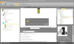

Hello!

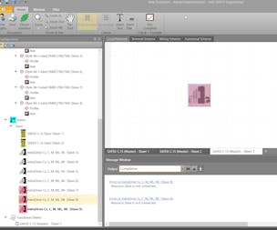

If I create an empty project with a Safex C15 as ethercat master and try to add Safex slaves and Rexroth IndraDrive slaves at some point system will marked added devices with red color and compilation will generate error. Or sometimes that resource checker pop-up window appears and doesn't add a device. The problem is that it can happen that first project is ok and can be compiled, but after modifications in functional scheme few devices are red and project can't be compiled. Even if I delete all servo devices it will complain about resources, just when I delete one of the Safex slave I can add servo devices back. Could someone explain me the restrictions of device to be added? I know only about max slaves number is 32, but here we are far away from that number. The software version is 1.8.3.10207

Hello CodeShepherd,
to tell the truth I didn't have time to investigate that bug anymore, I've just used version 1.7.6.9968. There is no issue in that version.
