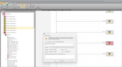

Using a large project that contains 8 safeX communicating over SMMC, when a project is copy and pasted in safety engineering 1.8.3 the software crashes. I'm able to copy over a blank project, but with the full project (20+ I/O per project, ethercat data transfer, fastChannel) Safety Engineering crashes. The exception report generated is attached.
After the software crashed, I was able to open a recovery file. I found a section that was deleted during the copy and paste, so I thought that might be the issue. I removed those items and tried a new copy and paste. This second copy and paste also failed, but with very different issues in the recovery file. My theory is there's a memory issue and when that memory runs out, the next item being pasted is what gets messed up crashing the software. By deleting the initial items, I moved the problem to the next thing being pasted.
