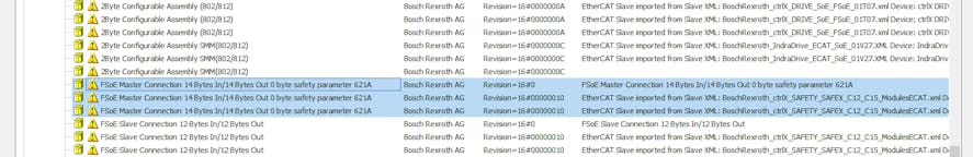

After installing the correct SAFEX-C1x device description file for the running firmware\FPGA we still had the 0x001E: Invalid Input Configuration. What we found was the elements for the FSoE Master Connections did not get installed:
After several attempts of uninstalling - reinstalling we exported the missing elements from another PC and installed them manually, this process worked:

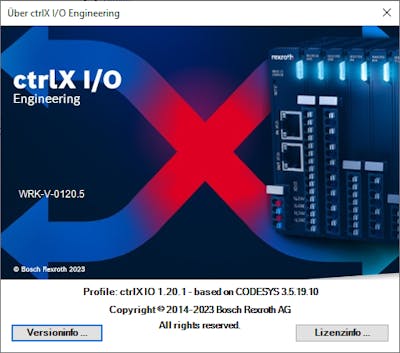

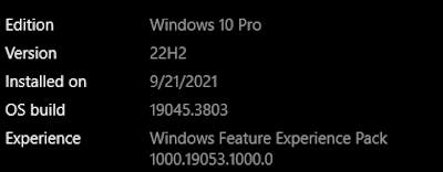

Here is some additional information about the PC and I/O Engineering:
