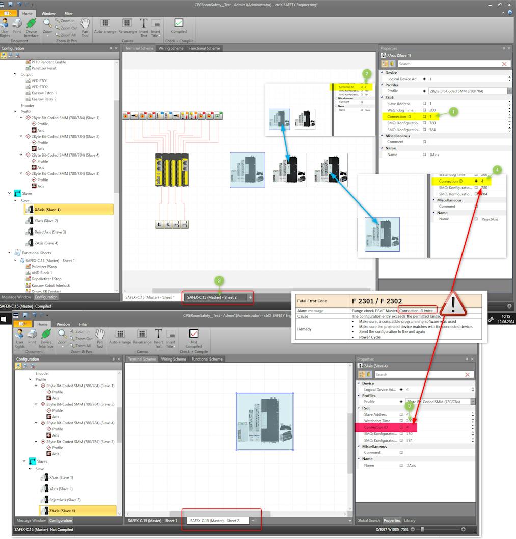

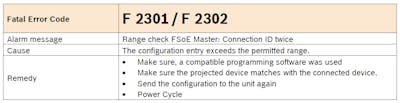

I have F2302 fault on a C15 safety controller with 1.0.1.45 firmware.  I'm using ctrlX Safety Engineering 1.7.6.9968 software.  The documentation suggests these remedies:
I have done all of them but suspect that the "Compatible programming software" might be an issue.  How can I verify that I have the correct fw and software versions?  If these version are compatible, what other issues could cause this fault?  I attached a zip file with my Safety project.
The serial number of my controller is 7260 150001181 DJ.  Actually, I cannot verify the firmware in the controller because the SystemInfo is not populated when the Diagnostics icon is selected.  The controller has not been updated since it has been shipped.  We are guessing based on other serial numbers that the fw is 1.0.1.45.

Hello Mr. ctrlXnovo,
the diagnostic of SAFEX is correct - points directly to the configuration error in your project ๐Ÿ˜‰             (Connection ID "4" - tice time  used)
good progress and success with SAFEX-C.15 !
