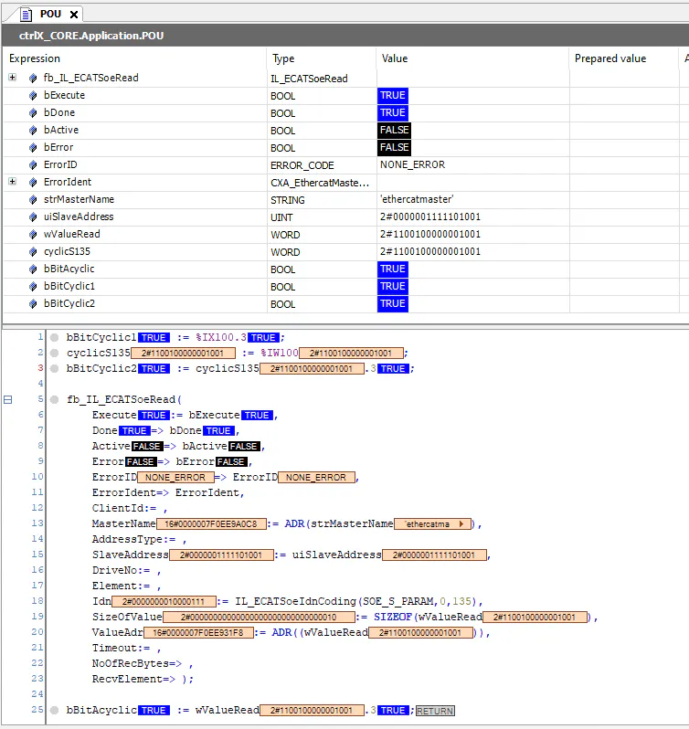

The S-0-0135 is in standard part of your cyclic communication, so do not need to read it acyclic. See here my examples working for both:

Picture:
Read S-0-0135 cyclic and acyclic
