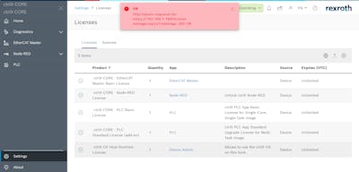

I'm currently using the X7 and am facing some issues with the PLC lisense. When installing the PLC app, there will be a error saying "PLC license error - Missing license". When opening the license page, the error in the image pops up. I don't know if this may be the issue causing the missing license.ย
In version 1.20 the ctrlX CORE X7 needs all four PLC licenses (Basic + Standard + Advanced + Performance) to work. See also ctrlX AUTOMATION - PLC description in the store area in the community.
