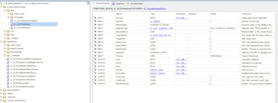

As far as I know there is a function to read a parameter from a slave with acyclic communication :
But this one is used as when the CtrlX Core is the Ethercat Master
