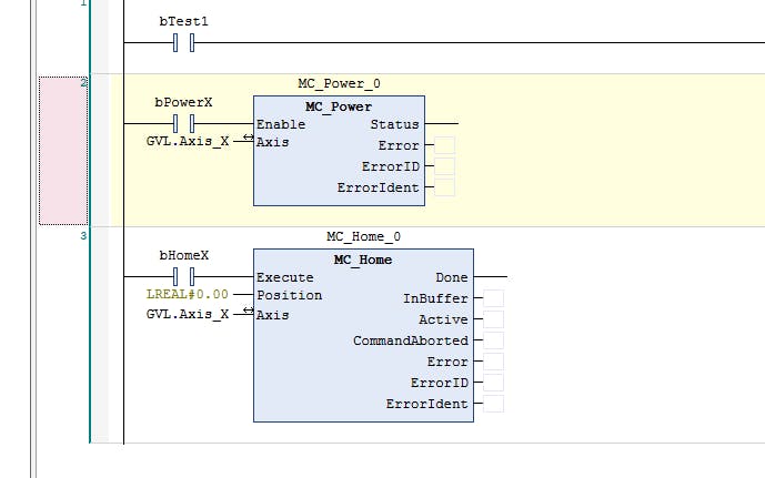

Trying to use MC_Home with ctrlX drive and "Current Position" to set position to zero.
ctrlX Works 1.20.10.Ā Apps from system image 1.20.12. Core X3.
Get 090F2000, 0C550001 Error.
Drive shows F4037.
Anyone else run into this?
Drive shows F4037.
There are similar discussionsĀ like "F2037 when homing".Ā
Please also use the latest ctrlX OS - Motion app in version 1.20.11 as there have been fixes for issues with MC_Home. Best is to always add a system report to your posts, so we get the most informationĀ available.
