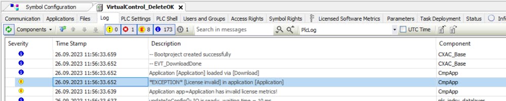

In ctrlX PLC Engineering (2.2.0) I see an exception (upon download) after initially adding tags to the symbol configuration:
After Reset Origin, subsequent downloads (i.e. Login>Download) complete successfully and the symbol configuration works as expected.  Also, if further tags are added to the symbol configuration, no other problems seem to arise.  The issue only seems to happen when going from an empty symbol configuration to a non-empty symbol configuration.  See attached video for further clarification.  PLC project is attached, but there is very little content beyond the standard boilerplate code.
Can someone confirm whether this also happens on ctrlX CORE X3 w/ latest firmware (2.2.x)?
Virtual CORE base image: 2.2.4; PLC app: 2.2.0; no other non-system apps installed.
