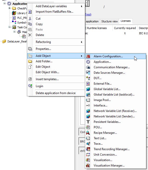

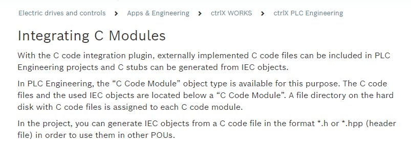

Our documentation implies that users can integrate C code into their PLC Engineering projects:
Do we actually support this?  I do not see the required object ("C Code Module") in the context menu,
nor is it clear to me that we are including the required runtime license.
If we don't currently support this feature, are there plans to support it in the future?
Thanks, -Carl
Best reply by georkueh
This feature is currently not supported for ctrlX CORE devices. We will provide a mechanism to integrate external PLC POUs in combination with our SDK until RM 24.03.
