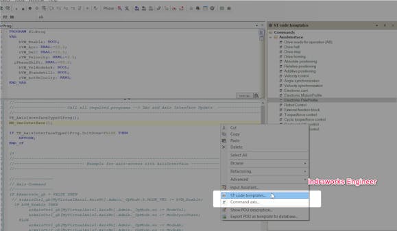

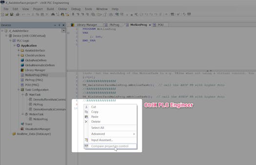

The function "Commond Axis…" or "ST code template" in context-menu is go away in CtrlX PLC,is there any way to run an axis conveniently ?
or will “Commond Axis” come back in the future? it's really helpful for new customers.
At the moment (Version 01V06 RM20.11) there is an axis-, kinemtaic- and IMC-interface available.
See this thread for further information.
And GAT like known in the MLC is actually not prioritized.
