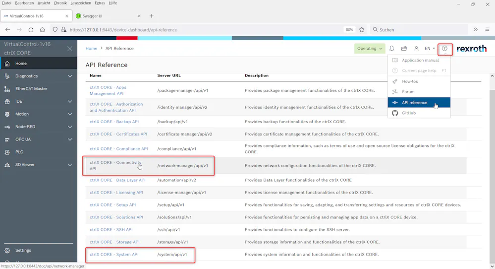

At the moment changing them is only possible via the REST API named "ctrlX CORE - Connectivity API" and "ctrlX CORE - System API" via https communication. So could implement a corresponding library and do the requests as described in our Swagger documentation that can be found on your ctrlX CORE WebUI:
ctrlX CORE WebUI API references Connectivity and System
See also the blog post "Using the REST API of ctrlX CORE [DOCU] - [VIDEO]" in our ctrlX AUTOMATION Community for some general information.
