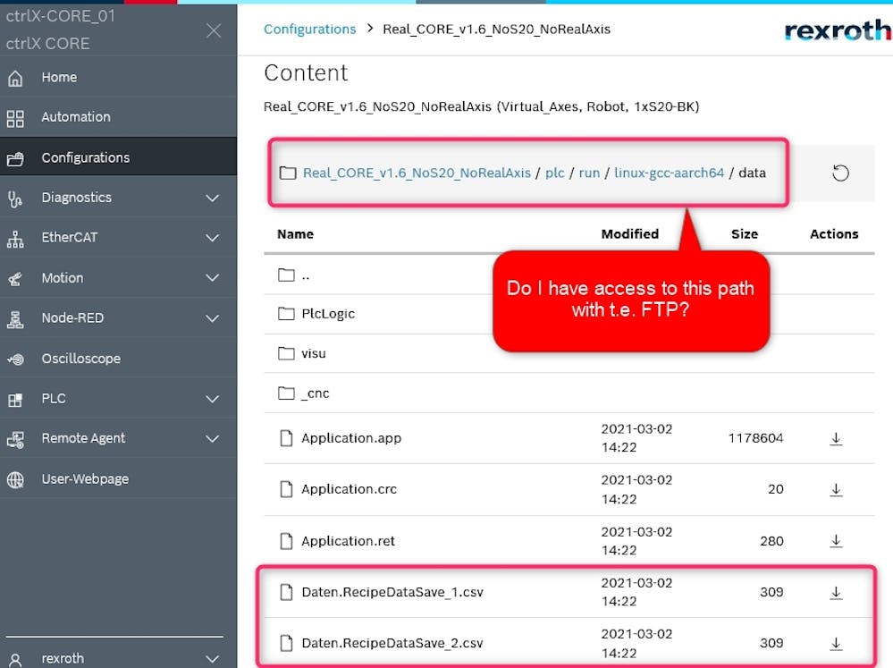

Access to plc recipe files stored on ctrlX CORE?
How do I get access to recipe files or files generated by the PLC which are stored on the ctrlX CORE? T.e. I want to backup the files on my PC or I want to transfer new files to the ctrlX CORE via FTP. I can see the genereted files inside the Configuration...plc/run/linux-gcc-aarch64/data, but where can I find this path t.e. with FileZilla:
Best reply by LunatiX
With FileZilla I was able to search for my generated folder and FileZilla found it here:
/var/snap/rexroth-automationcore/74/plc/data
