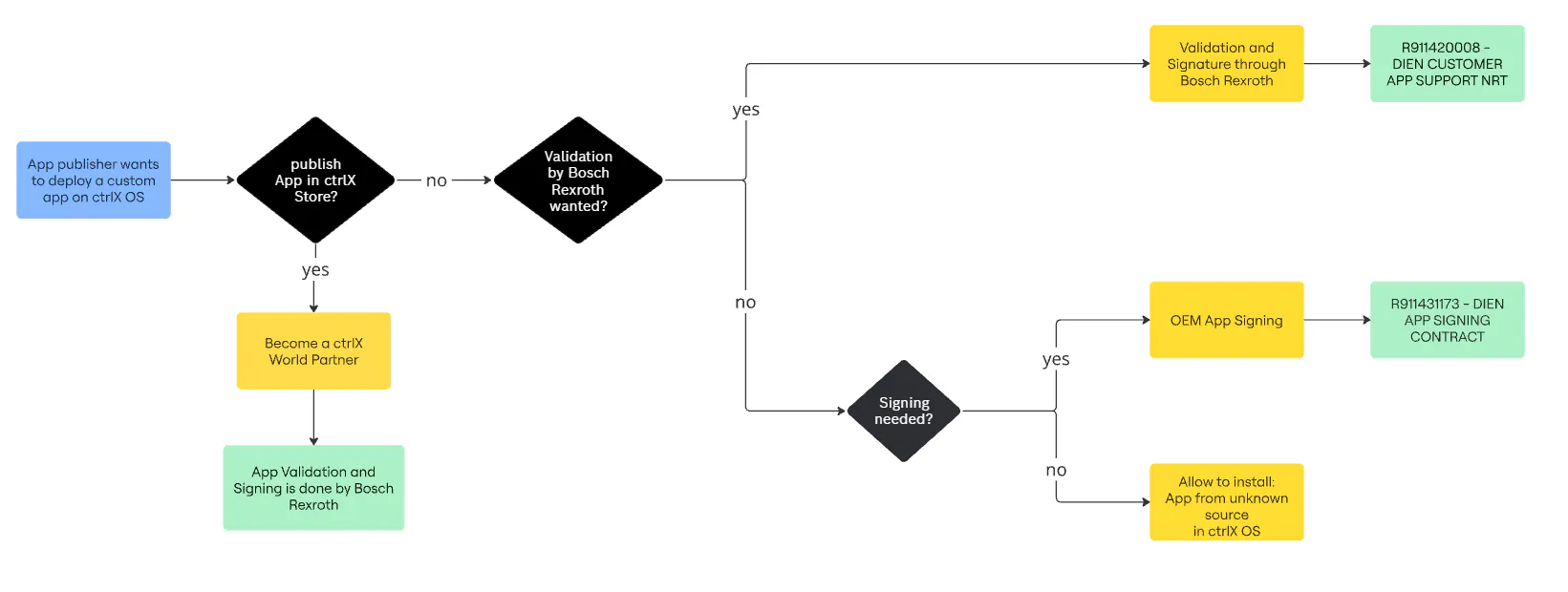

By default, the app management in ctrlX OS only allows installation of apps signed by Bosch Rexroth AG. Therefore, all apps in the ctrlX Store are signed. For the apps to get signed they needed to go through a validation process by Bosch Rexroth. To install unsigned apps users can disable this functionality on their ctrlX OS devices which will heavily affect the systems integrity.
To keep the system integrity and to be able to install custom apps without relying on Bosch Rexroth for validation and signing of an own app, the OEM App Signing can be used. The OEM App Signing enables app publishers (e.g. OEMs) to sign own apps for the secure use on their own machines and applications. The OEM can use the OEM App Signing for own apps using his own private key and signed OEM certificate issued by Bosch Rexroth AG. The signed apps can then be installed on the controls where the app publishers App signing certificate was uploaded.
Difference to App Validation and a ctrlX World Partner App
In contrast to the custom self-signing of own apps, it's also possible to purchase the App Validation package or to become a ctrlX World Partner and distribute the app via the ctrlX Store.
In both of these cases an app validation is done by Bosch Rexroth and if the app passes the validation, the app is signed by Bosch Rexroth.

The general steps are the following:
  1. Generate your private signing key
  2. Create a Certificate Signing Request (CSR) for this key. Send this CSR to Bosch Rexroth AG as a signed mail to [email protected]
  3. Bosch Rexroth AG signs the CSR, and sends the Custom OEM App signing certificate back
  4. Sign apps with your private key and OEM app signing certificate
  5. Upload the OEM app signing certificate to your ctrlX OS devices
  6. Now your signed app can be installed
