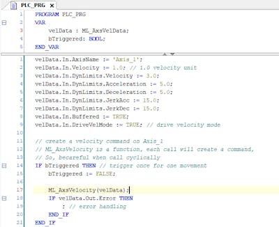

But firmware inferface is avialiable, that is CXA_Motion, you can take this way:
- Install ctrlX works 1.14.x
- update image of ctrlX CORE to 1.14.x
- install MOT1.14.x and PLC 1.14.x
- using CXA_Motion.ML_AxsVelocity() to create a velocity command on axis.
Example code like this:
