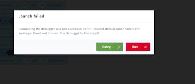

When I try to debug the program it comes up with the following error.ย

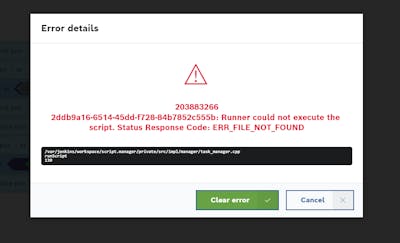

When I try and run the program it comes up with the following.
This happens when I run it in both versions of ctrlX Works.ย

When resetting the app data the folder "Scripts" will be deleted and IDE is not longer working correct. You could now:
  1. Get this folder from an saved app data archive and load the data to the actual active app data.
  2. Uninstall the IDE app and install it again to create the folder.
