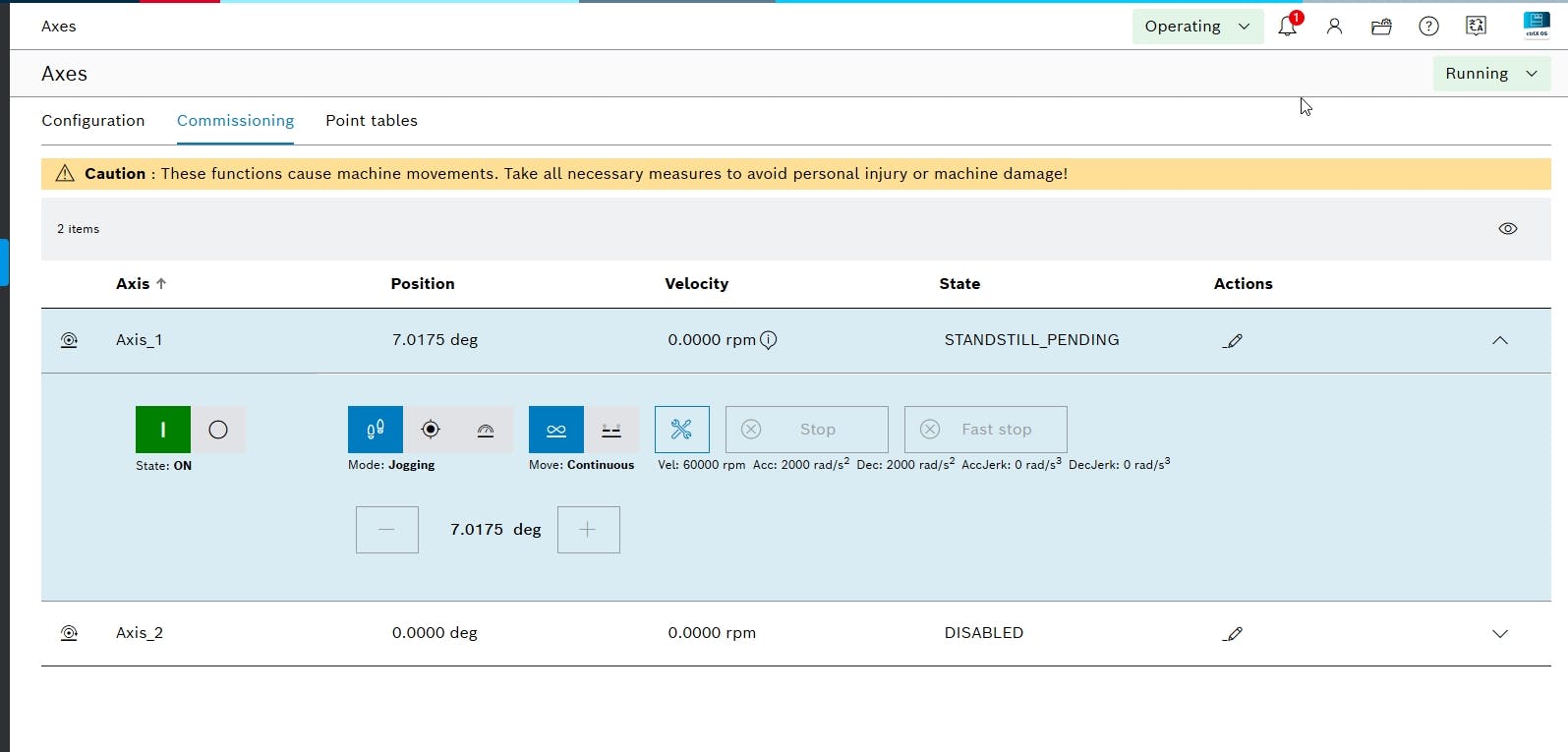

- Once the axis is activated, it remains in STANDSTILL PENDING and I can't move it.

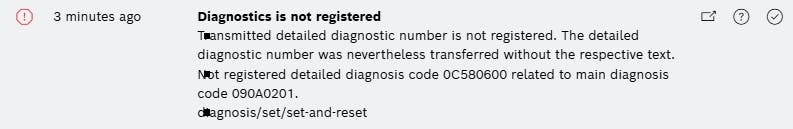

- I get an error that keeps popping up:
What could be the problem?
