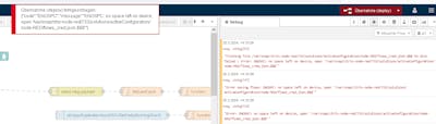

I had the problem that the Node Red Server lost the connection as soon as I want to read data of the OPC UA Client with the Subscription Node.
Because of that I updated the Subscription Node to its latest Version (1.9.5). I use the CtrlX V1.20 and the Node Red VersionΒ 1.20.0+3.0.2-ctrlx.
Since I made this update I canΒ΄t depoly anymore. I recive the following error message:
On the device is enough storage free.
Does anybody knows this kind of error message / problem?
Thanks in advance.

HelloΒ E_Stapel,
Seems that you need a clean start, reset the actual configuration πŸ™‚ . Plus in these days we're moving to the next version the 2.6 that will be the official LTS in July.
If the machine is going to be in production later than July consider to update to 2.6 πŸ™‚
