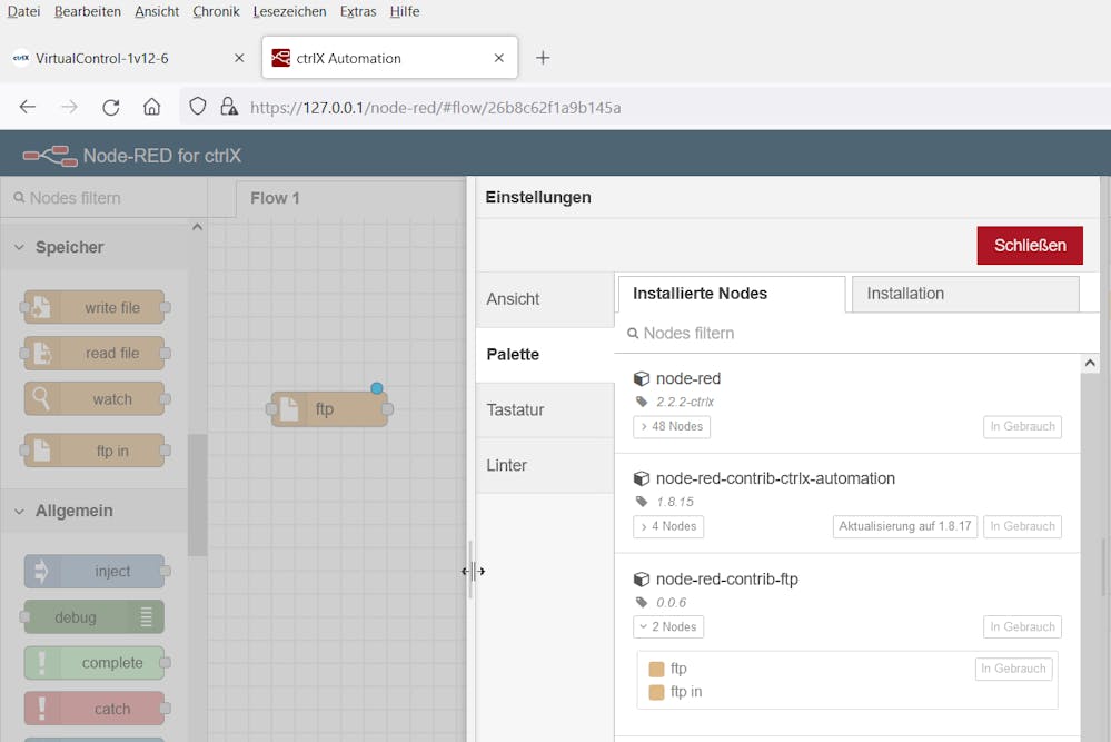

FTP commands to an external device posible?
We want to delete, list and download folders of an external device.
I know that if we want to move folders from an external source to the ctrlX Core is done via WebDAV.
On the other hand, could we do the above mentioned commands from the ctrlX Core to a FTP Server via NodeRed?
Thanks in advance,
You should be able to do this by installing an ftp palette into your Node-RED. I exemplary did with "node-red-contrib-ftp".
