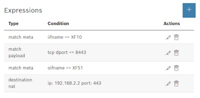

I try to configure the firewall to port forward tcp (http) traffic from the external to the internal network. For instance incomming to the IP of XF-10 on port 8443 needs to be forwarded to 192.168.2.2 port 443
The confusion already starts from port naming shoudl it be XF-10, ETH0 or XF10. I think the latter is correct beacuse this is the name Linux reports.
I understand have to enable packet forwarding for both XF-10 & XF-51 which I did.
According the this diagram I need to configurer Dnat, forwarding and SNAT rules
Which seems to be a lot since I only have a few coonfiguration parameters to play with:
  1. Incomming interface XF10(??)
  2. Incomming protocol TCP
  3. Incomming port: 8443
  4. Destination interface XF51
  5. Destination IP: 192.68.2.2
  6. Destination port: 443
Al that information can go into the destination NAT
Is this correct? And if yes what should I put in the forwarding dan SNAT entries?

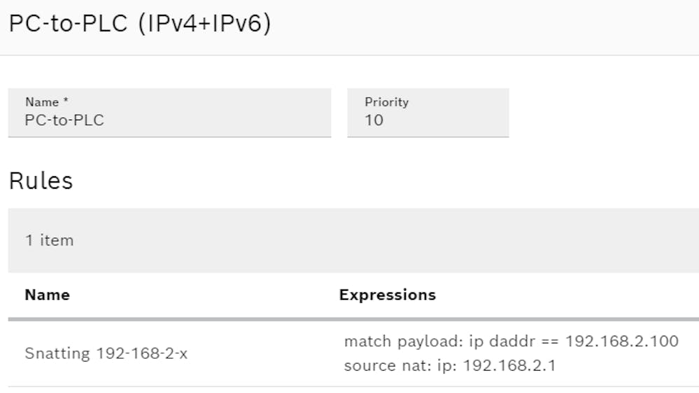

Hi Marc_Smaak ,
I believe at this point, you also need a SNAT rule to direct the response message.
As an example, if I had a device on the internal subnet at 192.168.2.100 and the internal subnet adapter IP is 192.168.2.1, I would use the following rules.
