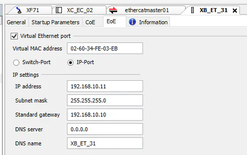

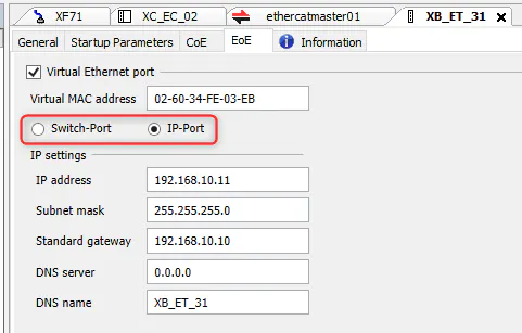

with "IP-Port" configuration and following settings :

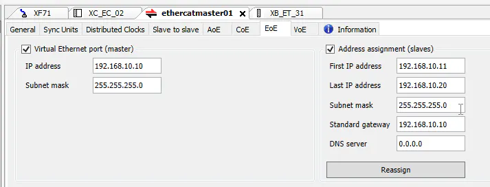

I have enable the following settings EoE settings on the Ethercat master :
On XB_ET_31 card when I enabled IP-Port features it was automatically configured like this :
This looks logical according to my EtherCAT master settings.

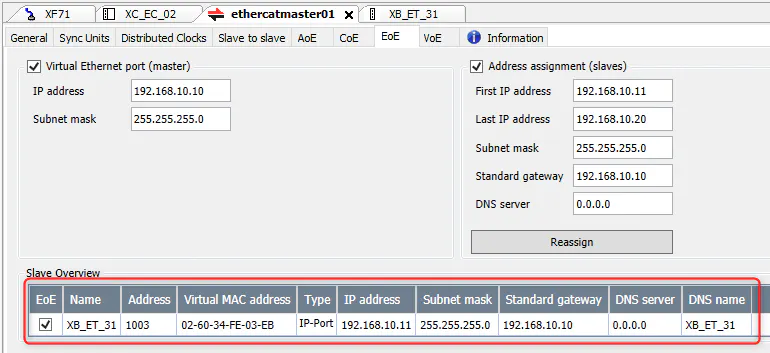

And on master EtherCAT side it is recognized :

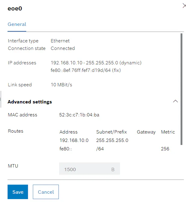

I didn't change anything in the Network interfaces settings :

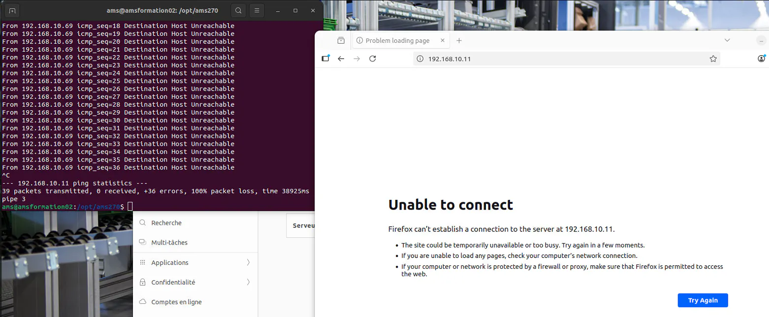

But when I try to reach the webserver of my ctrlX on IP address 192.168.10.11 it does now work and the ping request alos does not work :
Where could be my mistake? Maybe I didn't understand correclty how it shoudl work?
