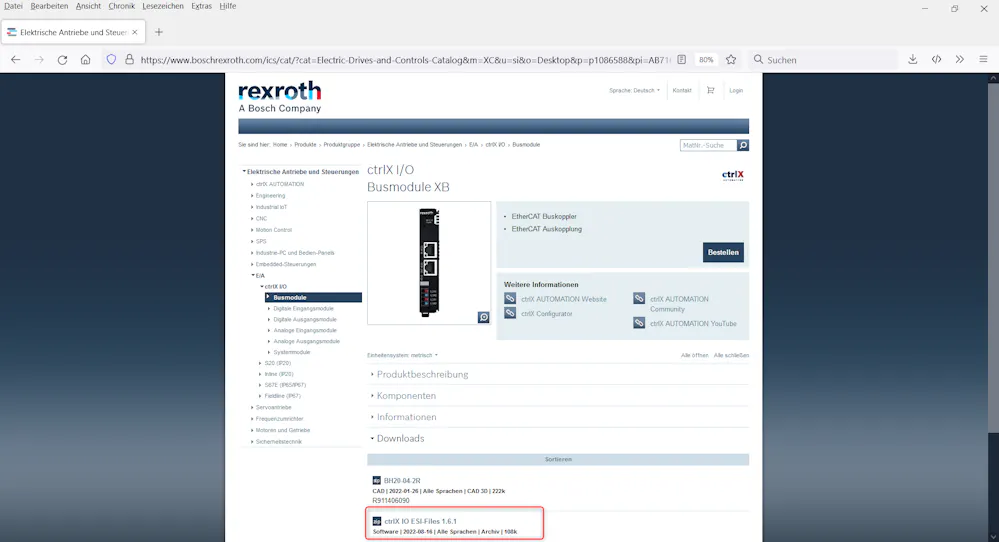

1. Where can I find the related ESI file ?
(the documentation send to http://www.boschrexroth.com/electrics but there is no ESI download, only youtube and configurator links)

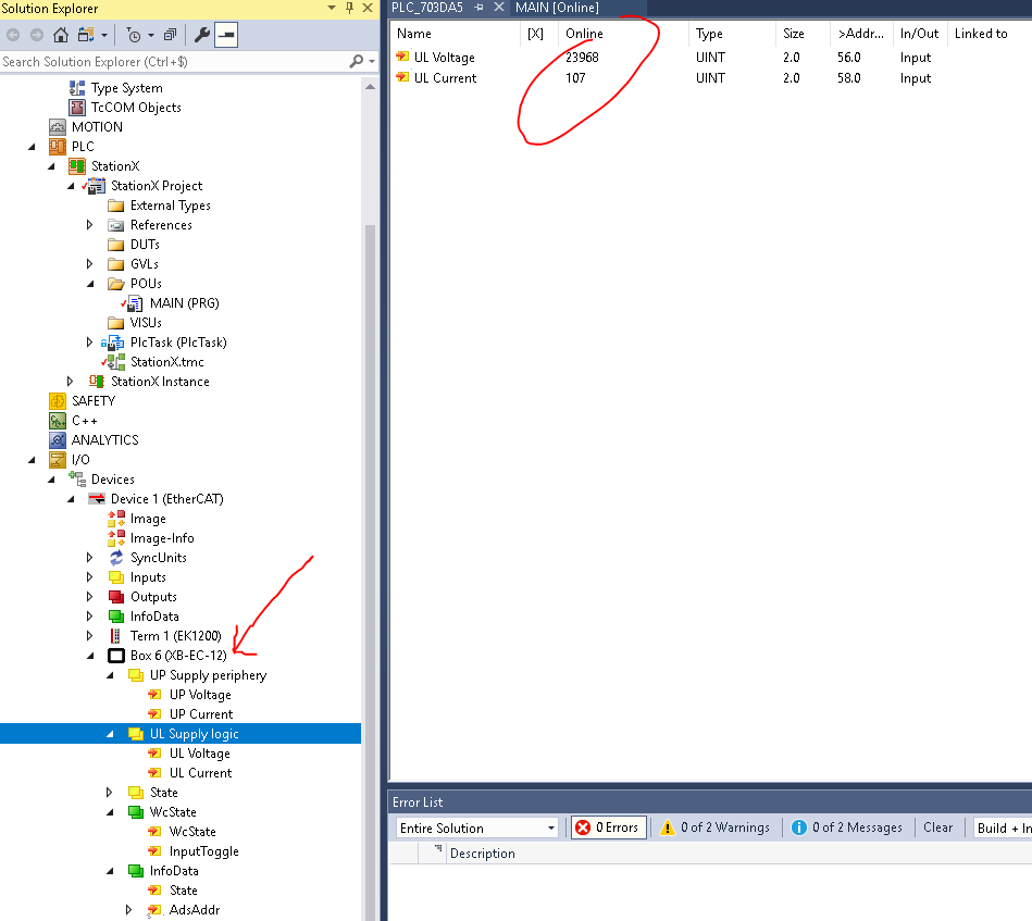

I tried a ESI found on a github repo but,
in TwinCat3 when online if I see moving data about voltage or other I do not see any data related to IO.

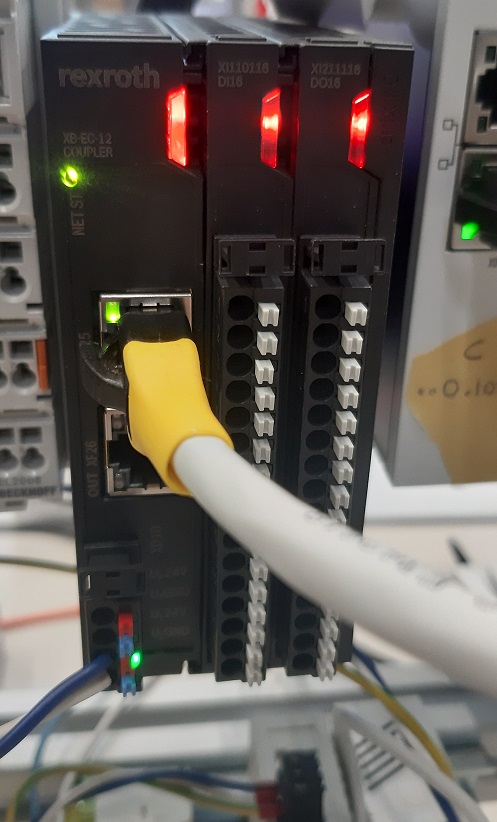

The leds on XB remain solid red
2. Should I use a software to build a configuration and then transfert it to the XB-EC-12 ?Â
In attachement you can find a picture of the device and the TwinCat3 tree

- On the page you mentioned there is also the ESI file in the download area. This file should include descriptions for all ctrlX IO.
boschrexroth.com ctrlX IO ESI file - Transferring a configuration is normally done via the EtherCat master and so creating it should be possible by using its standard tool.
