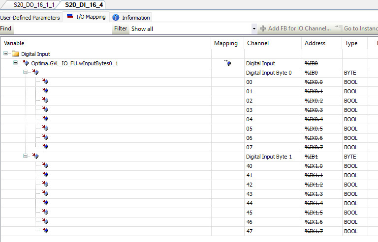

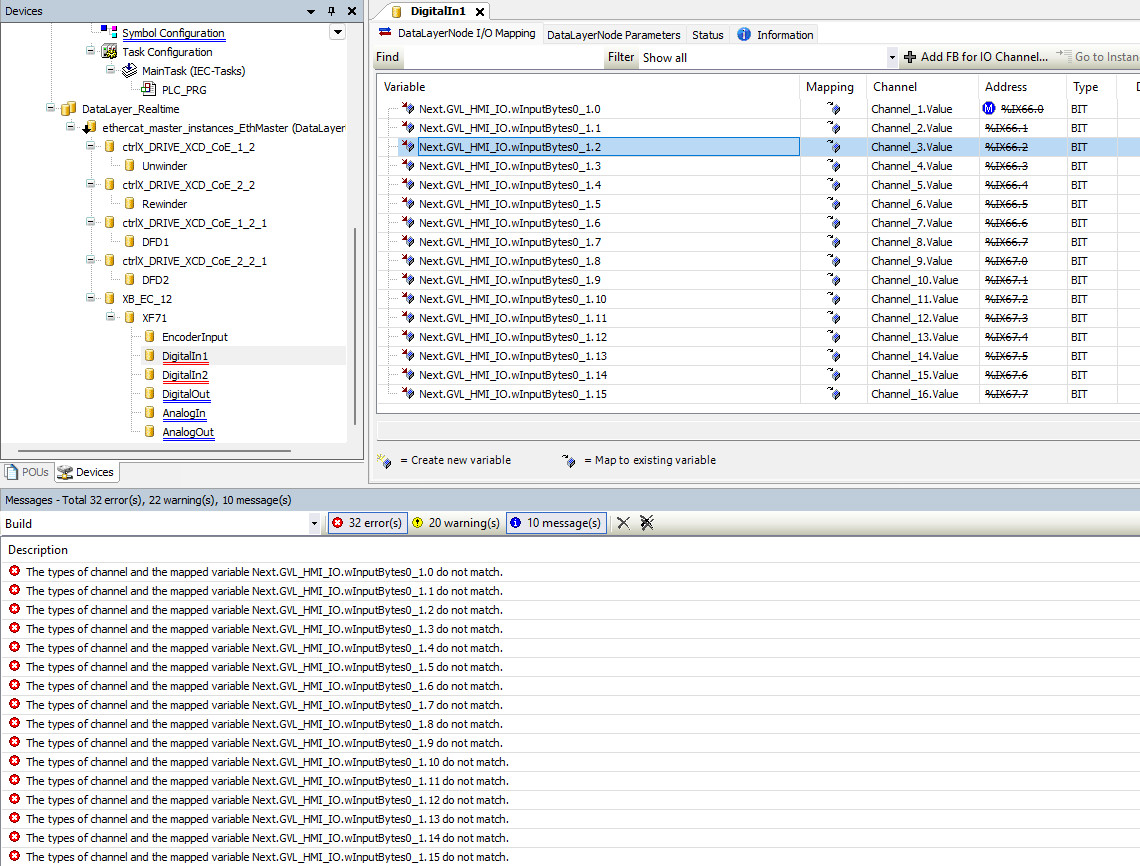

In Indraworks I can put a word to all 16 input or outputbits so I can easily read all IO, in CTRL-X this is not possible, but also not even the separate bits, it keeps giving me errors.
Anybody knows how to do this without addressing every input separately with a boolean??
First picture is Indraworks, 2nd picture is CtrlX works
